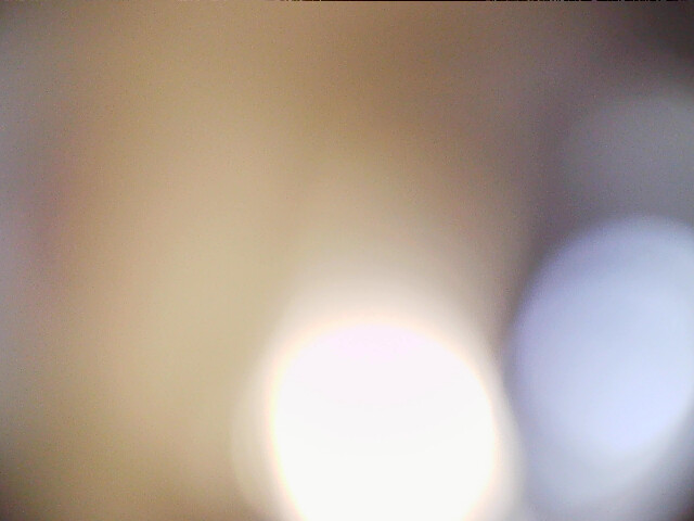

  2. What actually happened? Stream opens successfully and is visibly live (responds in real time to motion and lighting changes), but displays as a fine grid/moiré-like corrupted pattern instead of a coherent image. A real light gradient/shadow is visible underneath the distortion, confirming the sensor is capturing real data that’s being scrambled somewhere before or during output.

  3. Screenshot of result attached

Hey update was able to fix the issue. Had to adjust the focal length of the camera manually by twisting the lens barrel.
