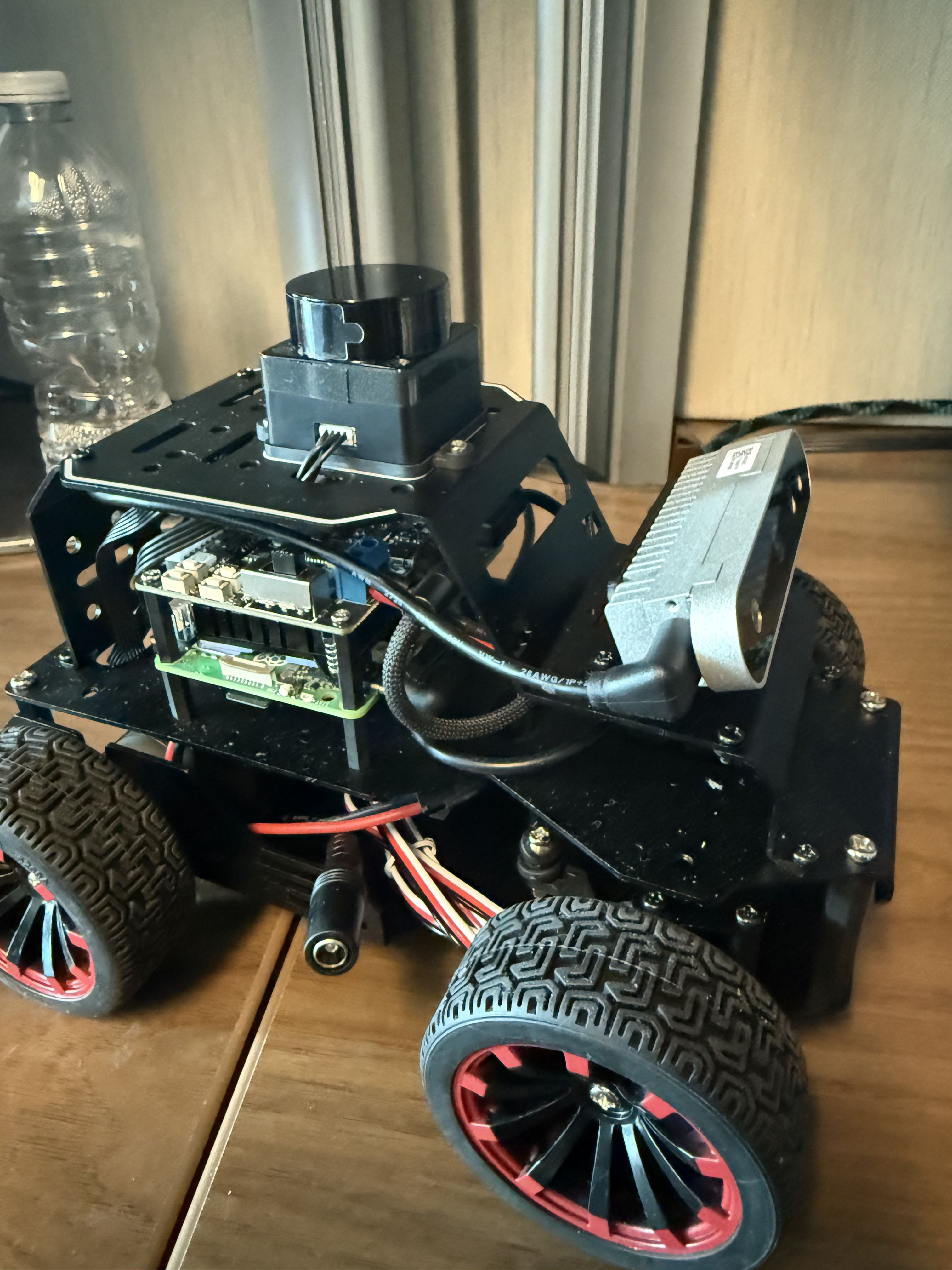

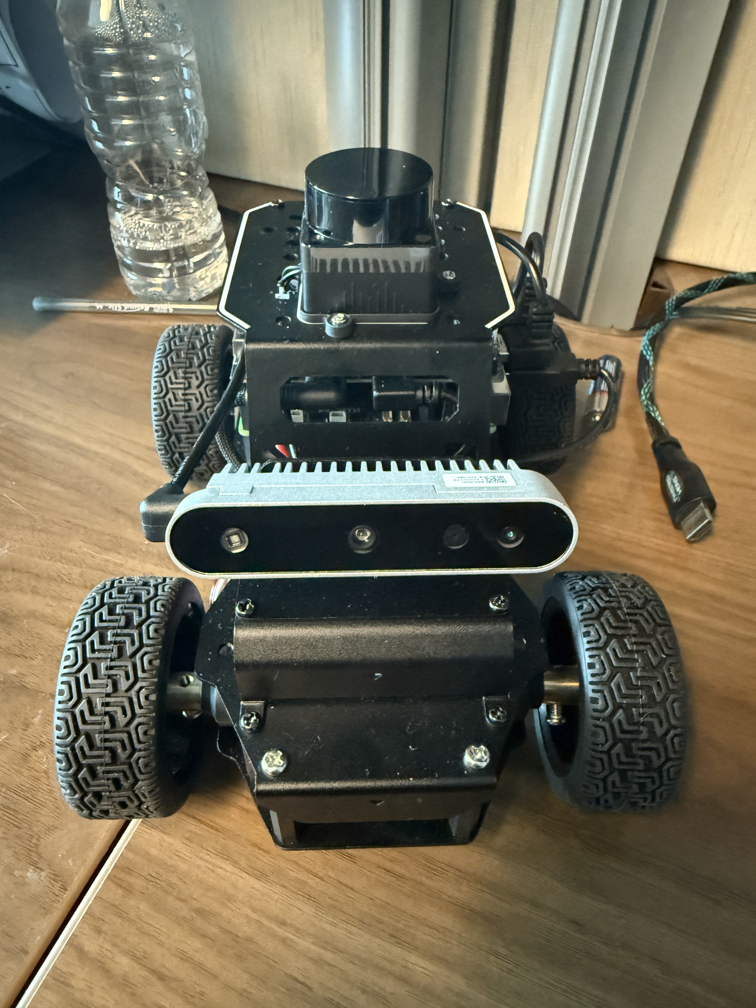

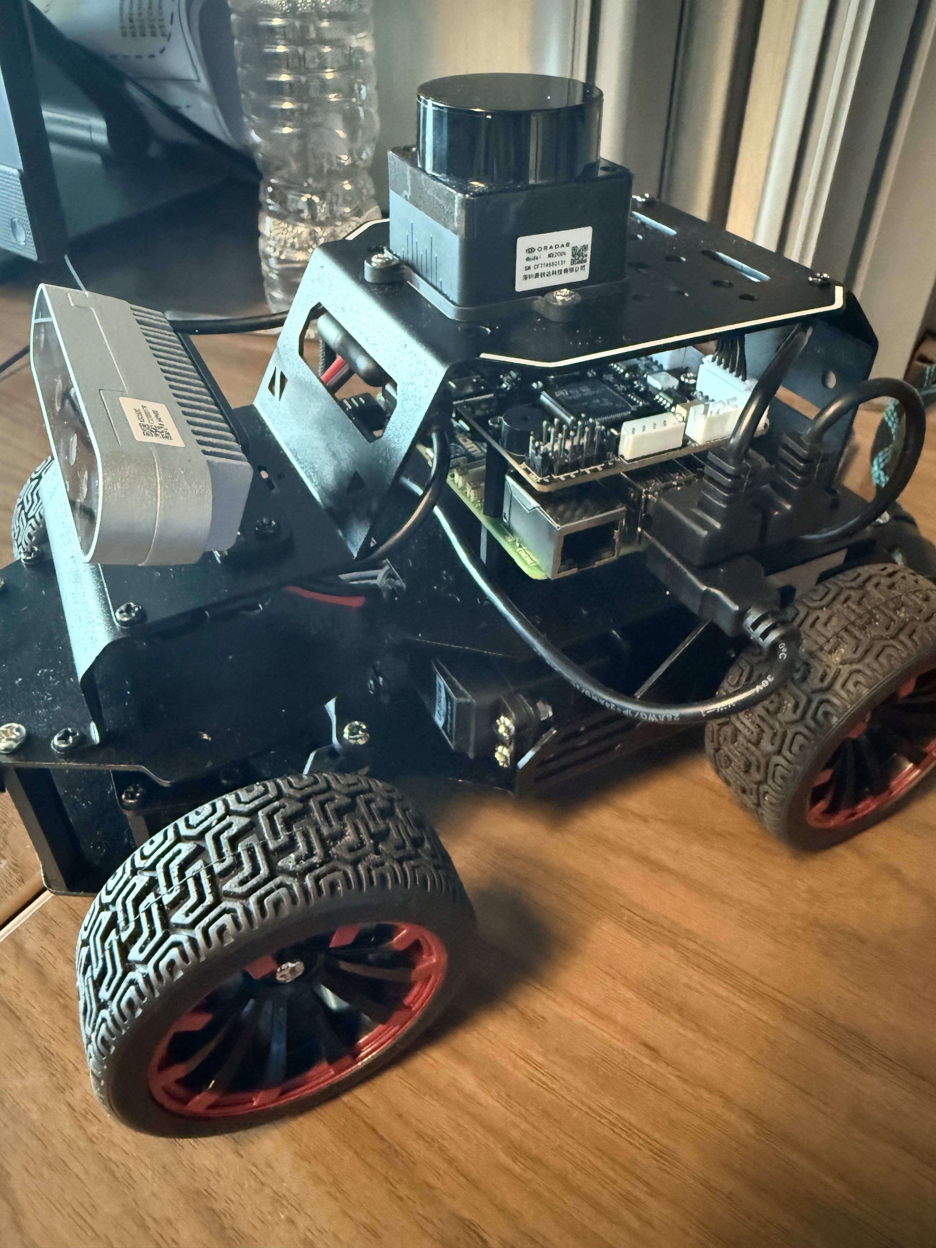

MentorPi A1: Angstrong depth camera (AS_CAM_HP60C) stops publishing frames after brief operation
:light_bulb: Using this template is recommended — you may also edit it freely, but you must fully describe your product and the problem (at least: product name, version, and problem description).
Product and Purchase
  • Product model: MentorPi A1 (depth camera version)
  • SKU or kit name:
  • Purchase channel: Purchased by university lab — not sure of original vendor
  • Controller board: Raspberry Pi 5, 4 GB RAM (aarch64)
Software and Environment
  • Operating system: Debian 12 (Bookworm), kernel 6.12.47+rpt-rpi-2712
  • Connection method: SSH from laptop on same Wi-Fi. Camera is USB (visible on the Pi as ID 3482:6723, “NOVATEK ASJ ZNX_NVT”)
  • Software version: Python 3.11.2, ROS 2 Humble (inside MentorPi Docker container), Angstrong camera SDK v1.2.22.20240516
  • Firmware version:
  • Image version: As-shipped MentorPi factory image
  • Tutorial step: Standard MentorPi bringup (auto-launched on boot); attempted to relaunch camera via ros2 launch peripherals depth_camera.launch.py following the Depth Camera Basic Lesson
Issue Description
  1. What did you expect to happen? The depth camera on the MentorPi (Angstrong AS_CAM_HP60C, SN ASC60CF32000179) should consistently publish RGB frames to /ascamera/camera_publisher/rgb0/image at ~15 fps whenever the auto-launched bringup is running.
  2. What actually happened? fter a fresh Pi reboot, the camera works briefly (ros2 topic hz reports a real frame rate). After some operation, the camera stops publishing frames and doesn’t recover. ros2 topic hz reports “topic does not appear to be published yet” even though:

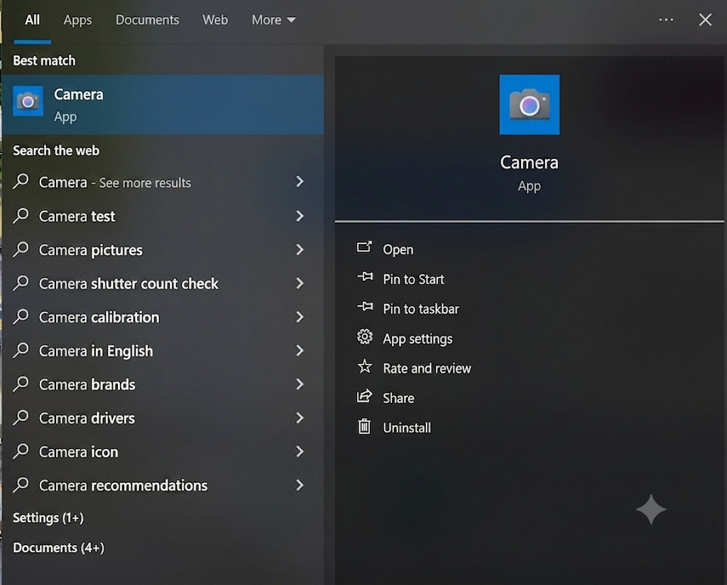

Have you tried plugging the camera directly into a computer to see if it displays a video feed using the built-in camera application? Testing it as a regular PC peripheral will help us rule out any hardware issues with the camera itself first.
Please follow the steps below and record a short testing video so our engineers can evaluate the result:
  1. Connect the depth camera directly to your computer via USB.
  2. Open your computer’s built-in Camera app (e.g., Camera on Windows or Photo Booth on Mac) and check whether the camera works properly.
