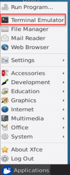

  2. Click the Applications icon in the lower-left corner, and then select Terminal Emulator from the pop-up interface to open the command-line terminal.

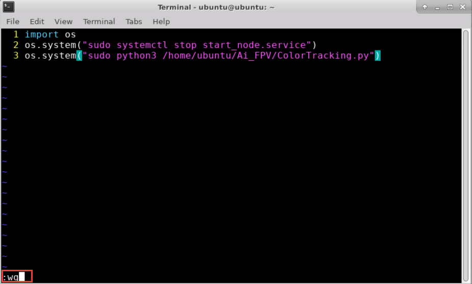

  1. Enter the command vim main.py to edit the program, copy the program below, and press the Shift and Insert keys simultaneously to paste the code. Once completed, press Esc and enter :wq to save and exit.
vim main.py
os.system("sudo systemctl stop start_node.service")
os.system("sudo python3 /home/ubuntu/Ai_FPV/ColorTracking.py")

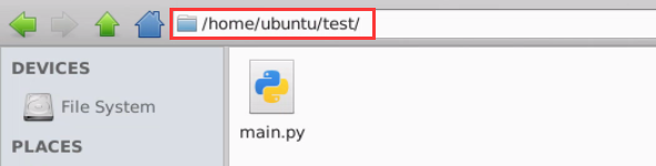

  1. Place the main.py program into the directory path /home/ubuntu/test/.
    The directory path can be customized freely without any restrictions.

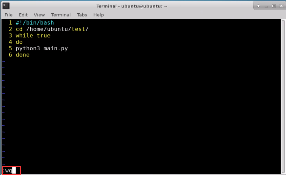

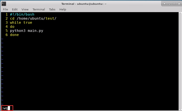

  1. Enter the command vim autopy.sh to create the bash script, copy the code below, and press the Shift and Insert keys simultaneously to paste the program. Upon completion, press Esc and enter :wq to save and exit.
vim autopy.sh
#!/bin/bash
cd /home/ubuntu/test/
while true
do
python3 main.py
done

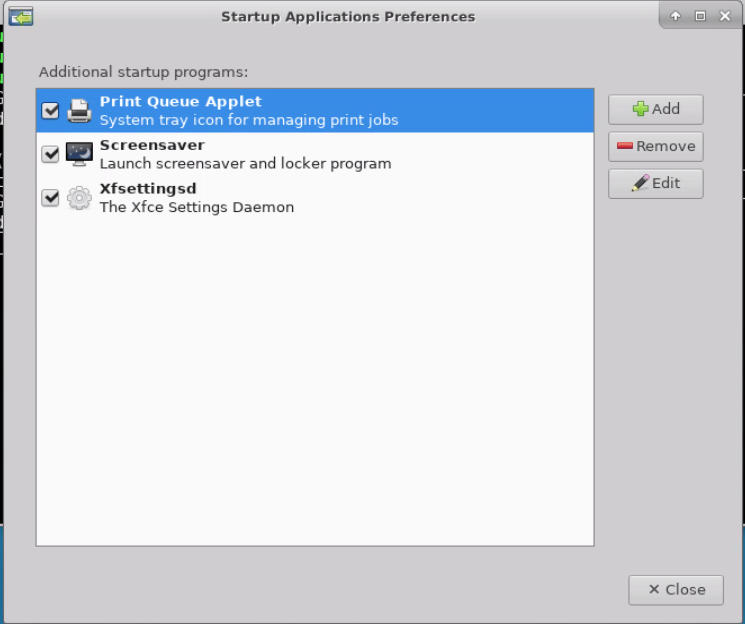

  1. Enter the command and press Enter, displaying the interface as shown below.

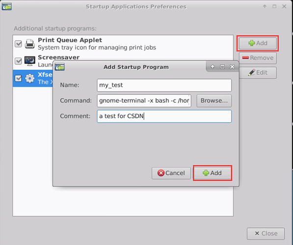

gnome-session-properties

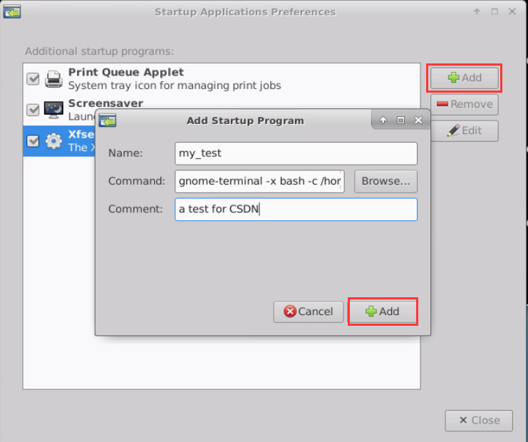

  1. Click the Add button and configure the settings as shown below.
The Name field can be filled according to specific requirements.

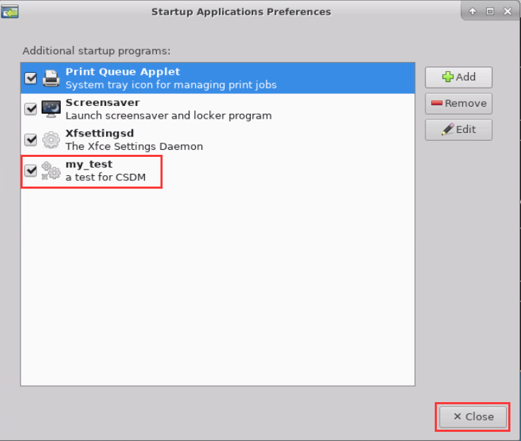

The Command field is critical. If the program needs to run in the foreground with the terminal window appearing upon boot, the following command can be entered: gnome-terminal -x bash -c /home/ubuntu/autopy.sh
The Comment field can be filled in arbitrarily based on the actual application, followed by clicking Add and then clicking the Close button.
  1. Enter the command to restart the system.
sudo reboot
  1. After rebooting, once the robotic arm returns to its initial posture, it will begin to move and track the red color block.
