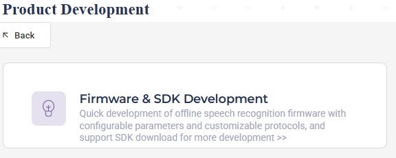

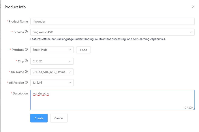

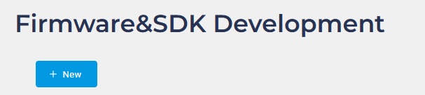

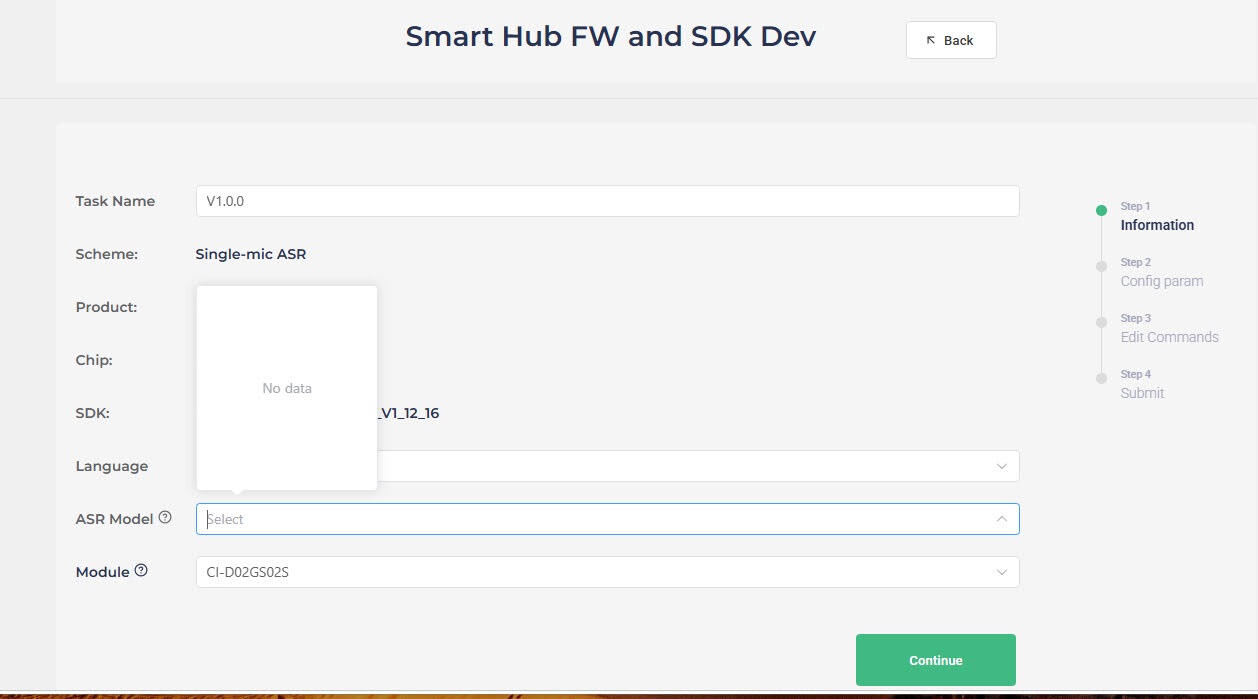

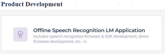

  2. What actually happened? The web pages starting at 初始页面 don’t match what is shown in the documentation - 5. Firmware Development — WonderEcho v1.0 documentation so I made my best guesstimate as to what settings to select. When I get to step 8, the ASR model listbox is blank. See below. Any thoughts?
Official support staff are being brought in to help with this firmware issue. If you still need my help, reply here and @ me. @Hiwonder_Scarlett

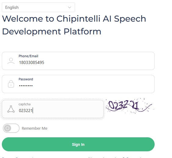

I found the answer to the question. After signing in, switch the language to Chinese and let the browser do the translation. That worked. However, I have another issue. When you get to the last web page where you submit the request, I tried to upload the Command Word Broadcasting Protocol List spreadsheet and it apparently is not in the right format since the table below it remained blank. What format does the attachment need to be in to be uploaded correctly?
