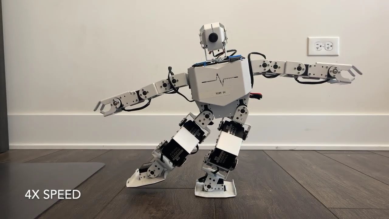

yes, just added a walking and standing balance using IK: https://youtu.be/xbgYgt3ijhk
Added inverse kinematics using mink (mujoco + inverse kinematics) and used that for creating statically balanced standing on one leg and walking poses, saved .d6a files, and played on hardware.
Video:
